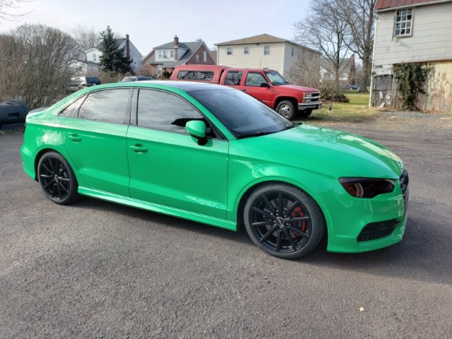

Great I hope you like them. They aren't as smooth as me running 18" rims but I really didn't like the look of 18's at all.
The 245's took some of the harshness out of hitting potholes. Before it felt like the wheel was being ripped off.
This pic is with 18's
