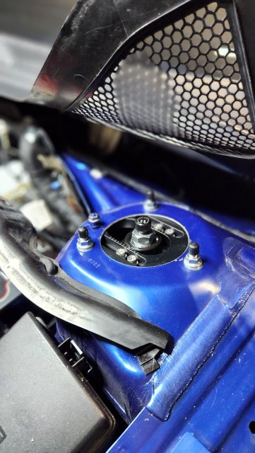

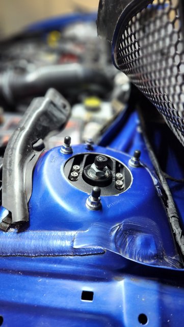

for the installation part i had to decide on how to have full control of the top knob adjuster and have full access to the top hat area for the fronts. that screws that allow us to adjust camber in available on these and i didn't want to have a hard time to adjust them. so i decided to modify the front strut towers to allow a larger hole for that.
this is before i cut out the hole.
this is after the cut. both sides had the same treatment. full access.
656
Thread Starter #9
here are some more photos of the strut tower.
