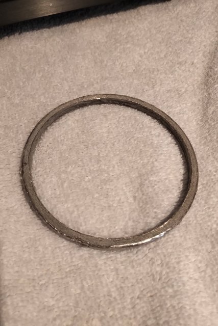

a few days later i got a check engine light. cel/mil.
i scanned it with vcds. came up with 18933
it happened when engine braking. not during acceleration. that's the key to diagnosing this symptom.
the issue is that the secondary o2 sensor is sensing extra air. this code means new air is coming in or sucked in. it can be anything such as hoses, PVC, etc. but i didn't touch any of those things while doing this downpipe install.
so the next logical thing is the downpipe is the issue. what i didn't do was replace the o-ring gasket at the turbo and the dp connection.
i just replaced it and nothing within the past couple of days.
part number is 5Q0253115B
very easy to fix. just open the connection with the hex key and pull apart while the engine is cold.
the gasket is deep in there since its crushed at this point. always change this out when doing the dp change or anytime you open it. its a one time crush.
part is about $10 at the dealership don't get aftermarket.

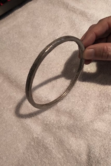

here is what it looks like.
it feels like cardboard paper glued together. its is very flaky and stiff but can break apart easily. so i would recommend handling it rough with the new one.
