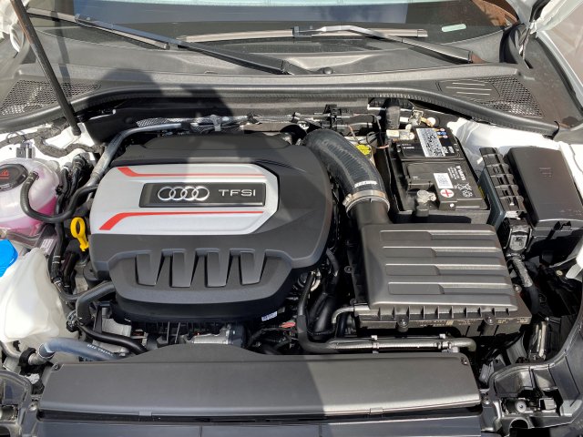

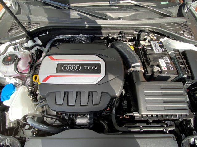

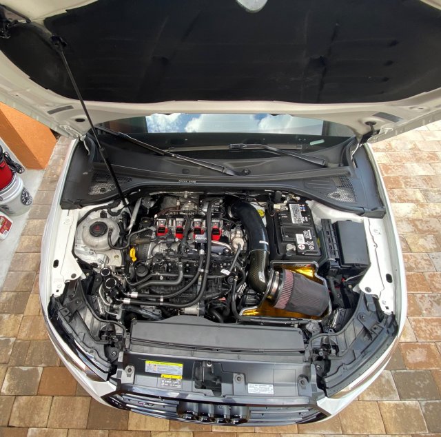

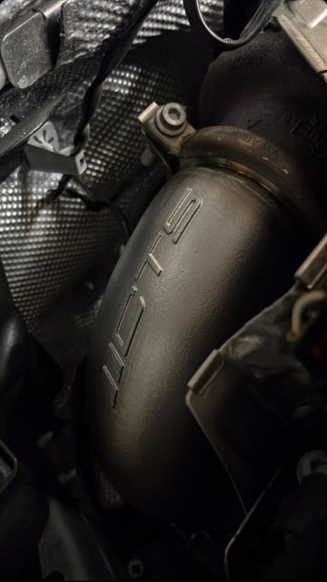

Hello Everyone, Just clocked a little over 1300 miles on the car after owning it for 3 weeks.

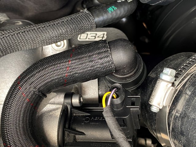

This morning I was able to replace the Stock Turbo Inlet Pipe with the O34 Motorsport "3 inch" And rubber inlet Tube. I will be keeping the Stock Air Box for the time being however I did replace the stock air filter with a Drop in filter. I do have the APR Carbon Fiber ( Whistle) Intake from my previous car, Still debating if I keep or sell it... More updates as I slowly continue on this build. Waiting for my NGK racing spark plugs and Coil packs to arrive. Then going for stage 1 Tune. Audi S3 02.jpg Audi S3 03.jpg Audi S3 2020 06.jpg

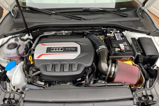

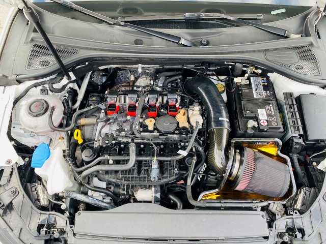

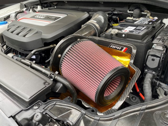

Quick Update:

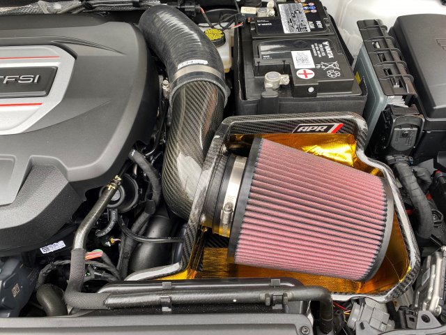

Found the APR Carbon Fiber Intake for a very affordable Price (dummy if I didn't buy it)
Decided to guy with small detail adding the Gold underneath the Filter. ( comment Below thoughts idea)
Overall The intake simply just makes the engine bay look nice.
Perfomance wise: No difference at all basically all noise.
Audi S3 01.jpg Audi S3 027.jpg Audi S3 026.jpg Audi S3 028.jpg Audi S3 029.jpg

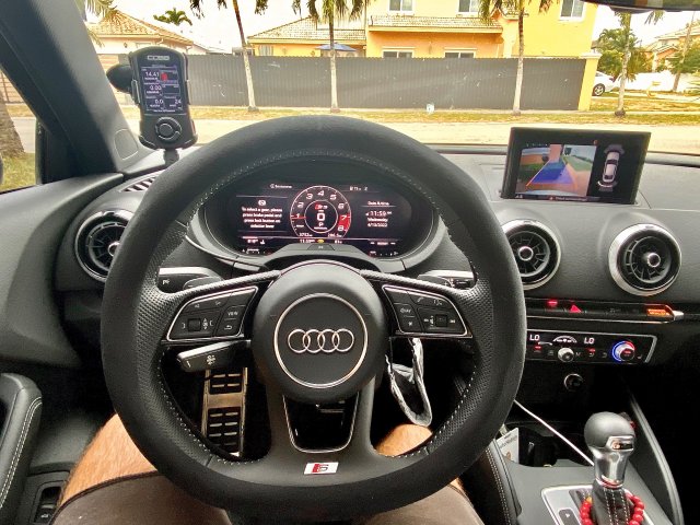

So I decided to go with the COBB Access Port and uploaded the Stage 1 tune and DSG tune ( sport).
The car feels a lot more responsive than stock
but still has some lag on mid 4th gear which is due to the base map.
My plan is to keep the stock map till the car reaches 6,000 Miles then get a custom tune on E85.
Although with all these Emission regulations I don't think I will be putting a downpipe which is the main key to making power on these motors.
Overall I can't get enough of this car and how much fun it is to drive.

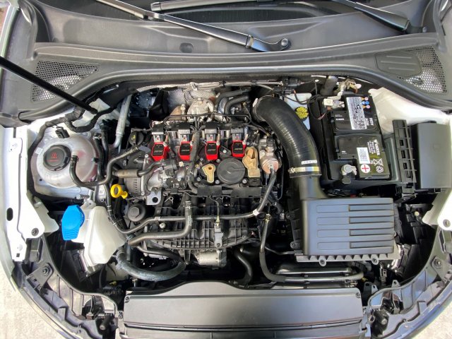

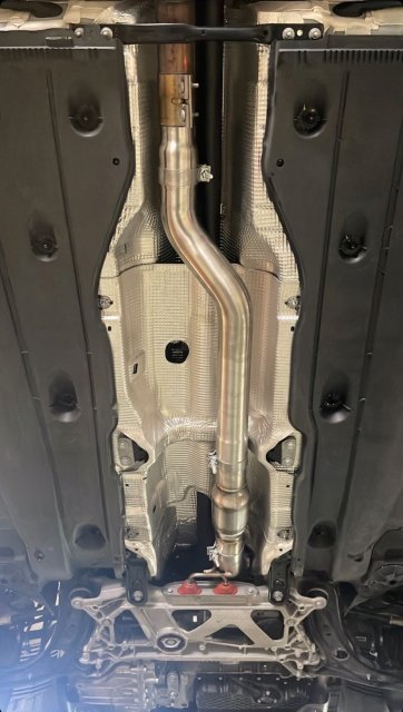

So today I finally went Stage 2 on the Car.
out of all the Downpipes available I went with the CTS 3.5 Downpipe and currently getting tuned by 5150. I also upgraded the Spark plugs ( NGK Racing RS7)
And RS3 Coil packs from APR

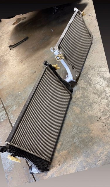

I ordered charge pipes and intercooler, mainly more for drivability than performance since during summer time I tend to drive more to the office and Miami has hot weather all year long

Installed the APR Charge Pipes & BMS Intercooler.
The stock intake box didn't fit back correctly due to the charge pipes being a bit thicker.

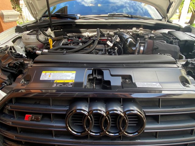

Added the APR Oil Catch can this weekend. As of now the car currently has all Supporting Bolt-ons, on a stock turbo still running on a stock Fuel Pump.
Also added the Black Badges
Overall Review:
The car is running solid with no hick-ups or hesitation.
I do find a difference in upgrading the Intercooler and Chargepipes. Highly recommend doing this modification, The car drives solid and also gets 33 MPG on my daily commute.
Car throttle response is just on point, definitely happy with how this build is coming along.
