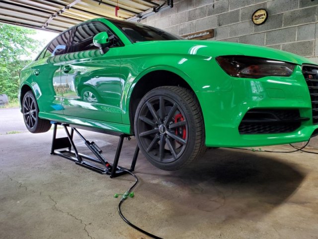

I also hate getting under cars with jackstands which is why I picked up a quickjack. Ramps would be fine for an oil change though. Don't mind the rims these are my winter set which I'm selling since I'm not going to be driving the S in the winter.

How do you like the quickjack? Can you post the model # and pad adapters? LWB? Any issues with it? The lift pads just center on the seams at the jackpoints? This is by far the worst car I have ever owned to lift. I have ramps and good jacks and stands but have not found it easy to keep the lift process safe to get all 4 corners off. I also run snows and do all my own maintenance but DO drive it all winter with 17" Sparcos and snows. Do you have enough room under for an easy Haldex oil change? Thanks!
Love it haven't had any issues with it. Great product. Mine is the quickjack 5000 no issues reaching the pinch welds. Works great for haldex or really anything. I feel a lot safer under the car.
I picked up the pinch welds blocks with mine. But you could use it without. Here's me lifting it a bit not even to the first position.
