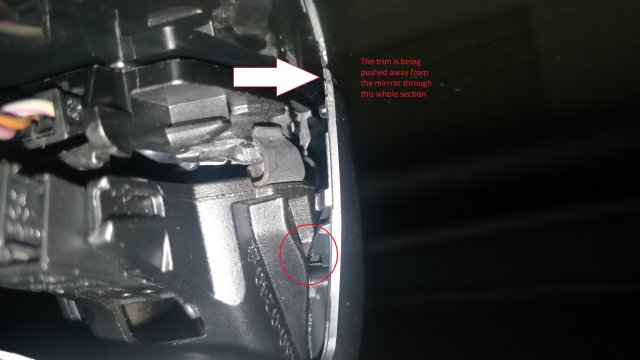

Here is the trim piece not fitting. Both side tabs on the trim hit the new mirror in a different place than the old mirror causing the trim to push away from the mirror:

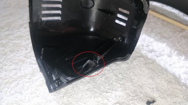

Here is the modification I made (basically used a dremel to shave off a small part of the tab on both sides of the trim that was hitting the new mirror).

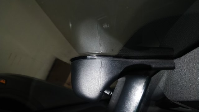

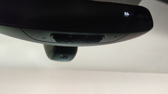

Here is the installed mirror after modification.
