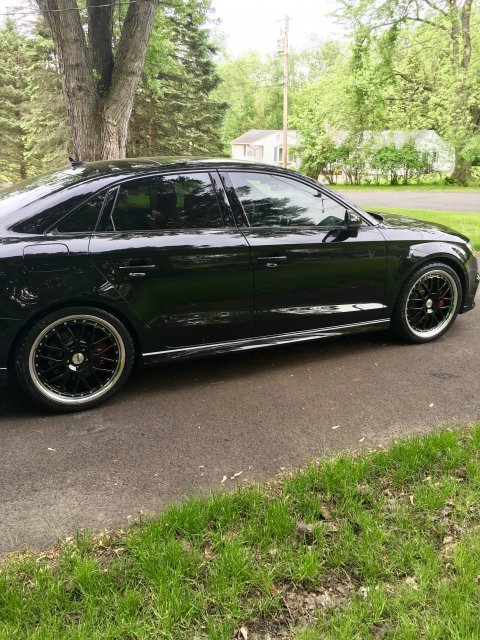

just going by aesthetics only, which rim size do you think will look much better on the s3?
i personally was thinking about going 18x9.5 inches, and lower it to match the fenders.
whats all your opinion about sizes?
if you have awesome photos post them up or photos of others cars you think are awesome!
